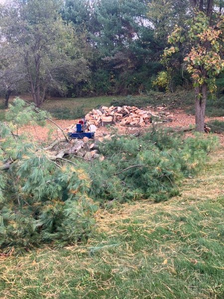

    IMG_1796.jpeg IMG_1795.jpeg I have some medium+ size white pine I’ve been cutting back around the house. One reason is too many needles in the gutters, plus I want a little more sun. I already have ‘wind break’ type trees a little further out.
    The next 2 have to much lean towards the house, I plan to use my tow strap hooked to a come-along, if solo. I have a ladder, will hook it high, tension, cut, more tension, etc.. It’s not the best firewood, but I mix it in.
