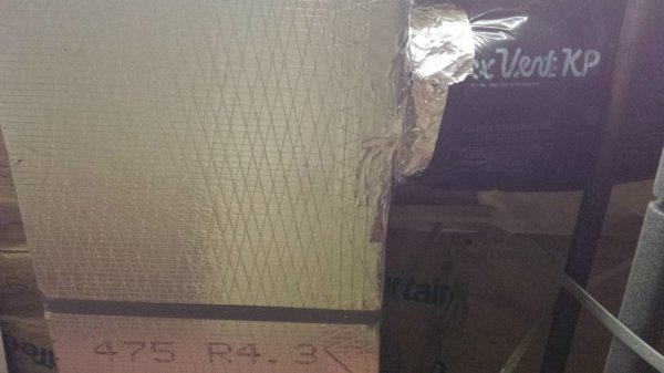

    Also, is any of your duct insulated? That would help tremendously. 100% off my duct is insulated. The main trunk is Certainteed UltraDuct Gold (1" thick) thats R value -4.3 and then the runs that go from the Main to the registers is R-4.2 Flex vent. Even if you could just buy some insulation and wrap the exposed ducts? The warmer you can keep the air, the higher your register temps will be? 343amc wrapped a fair amount of his duct, if I recall correctly.

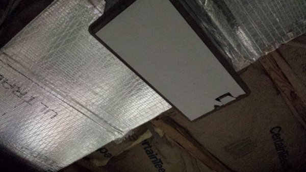

    Here are the magnetic covers (stops and seal vent almost 100%. Just closing the little flapper still let's air by. When only dealing with an 800 CFM blower? You need every bit of air you can get. Also, pic of insulated duct(main trunk and then the black flex vent sealed with foil tape).

    I see a register in that last pic. Things like that need sealed off completely. Get a good magnet or use foil tape. Also, around the edges of that register should be sealed with tape.
    Your only dealing with an 800 CFM blower. You need to keep the pressure up in your system as much as possible. That leak at that register is costing you valuable pressure and heat. Add in about 5 or 6 other small leaks and now the overall pressure has dropped and your flow to the father rooms is reduced.
    Sealing and insulating the duct is key here. One being just as important as the next. The hotter you can keep the air and the farther you can push it. The easier it will be to heat your area.

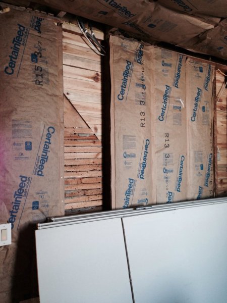

    We are planning to hook up the cold air return. We never had one going to the 2nd story of our house, it ended on the main floor. Why they did that I have no idea. We are getting it ready to be installed, see picture below. It will probably be a couple weeks yet before that gets done. Just not enough time in the day for everything.... image.jpg
  14. DexterDay
    DexterDay Administrator
    12,411
    31,637
    Northeast Oh
    You don't have to have it going to the 2nd floor. The air from up there will come down the steps
    Just by connecting into your 1st floor will keep the basement 100% out of the loop.
    It won't hurt to hook one up to the 2nd level. But just want you to know it's unneeded. The 1st floor will remove the needed air and air will naturally come down from the wind story.
