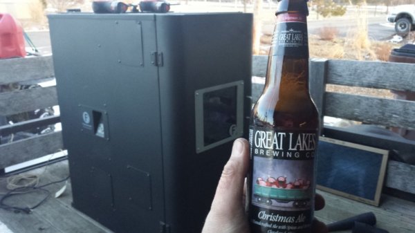

    Glad it's getting straightened out. My BIL likes mine so much, that he bought one. He is picking it up tonight. I went through and lubed every motor, greased the actuators, cleaned every orifice, and replaced EVERY gasket. It is as good as new. And I am FREEZING because I pulled it outside (my Garage lights suck). In about 15 more minutes, I will be done with outside work and will be modifying the burn pot.
    I have personally talked to the people at Fahrenheit (Matt Fitts) and walked away a pleased man. They strive to always make sure the customer is happy.
    Glad it's getting replaced. Glad they notified the dealer on a proper install. Keep us updated and don't be a stranger.
    As for the beers you would buy? I will consider the one I am drinking now, on you. :)

    I bought you a good beer! I am glad to know that I don't skimp out on a beer for a good guy! :thumbs:

    Christmas Ale is my favorite. To bad it's only made for a couple months a year. :)

    You should take a cue from Will and load up while the Christmas ale is available. It'll be hard to compete with what he has in his avatar though.
