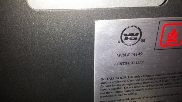

    The sticker on the back of our furnace has the serial number and it says certified 12/06. Did they even make these in 06?

    Yes. They did. My serial # is 2738.
    What serial # is yours?

    The first versions came out in 07. They've upgraded several things since then but the safety certs stay the same.

    Edit - I've got the old man furnace here. S/N 2349. No fancy LCD control panel here. Just LED's. :)
