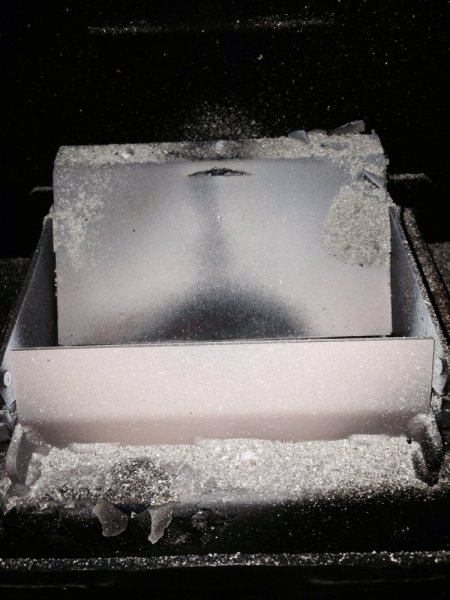

    The newer furnaces have a couple upgrades over the old ones. Next time you get a chance, can you snap a pic of the burn pot (looking down into it) and there is an access panel on the right side (when looking at stove). The newer furnaces have a high flow Exhaust manifold that helped my stove tremendously. Also there is an updated sail switch, but you will need to remove the Outside air line from the stove. (Not really a big deal and if the furnace burns as it should then you need not worry).

    I will try to get those pictures of the burn pot and access panel tomorrow.

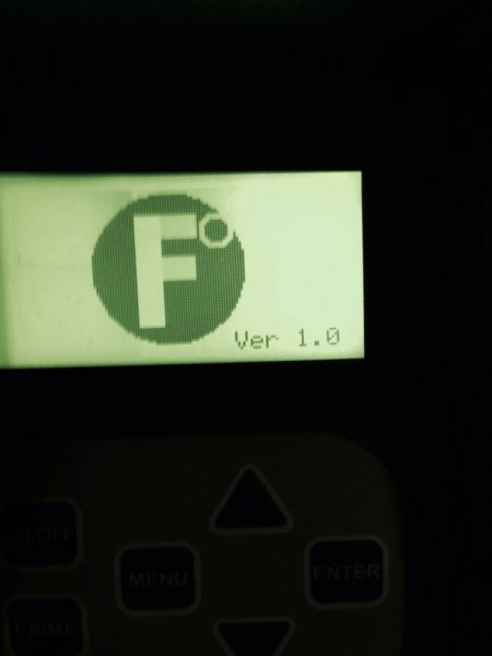

    Another question we have is that our owners manual says you have to choose hardwood or softwood pellets on the control panel. Ours doesn't have that choice, it has high ash as #1 and Pellets as #10. All the other are corn, cherry pits etc. I am assuming we just select #10...

    If you have the 600 and 800 setting, then what version is your control board? When you plug in the unit, it will show what "Version" of software the board had. Mine is V 1.2.

    Here are the pictures...I don't have anything on the right side of the stove though.
