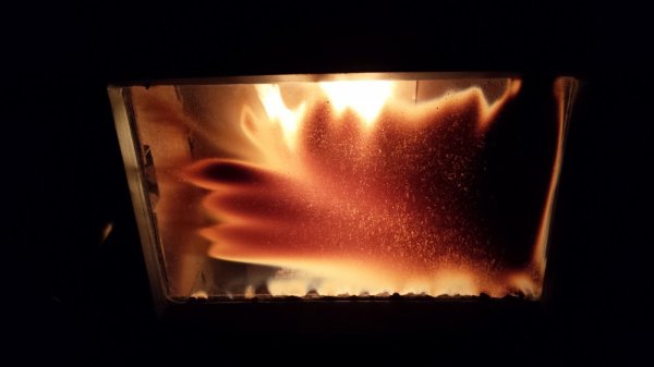

    I let mine go a long time this year. I only cleaned the Enerzone twice and the Fahrenheit once (didn't do the vent on the Fahrenheit yet). I just cleaned the glass on the Enerzone for the 1st time since Christmas :thumbs: The wife was getting a little mad at how nasty I let it get. . COULDN'T see the flame..
    The glass looks black, but it's just because the ash build up is so thick on the glass.
    Cleaning schedule should be more frequent. But I am "Testing" ;) lol..

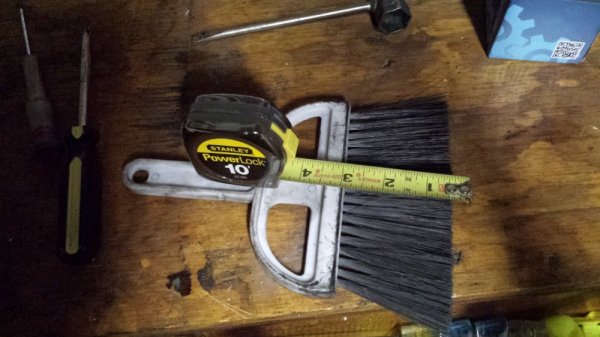

    I have been using a long bristled brush that I got with a little dust pan. It's almost long enough to go up the sides of the firebox, beside the heat exchange tubes, and hit the top of the firebox. Just barely hits it, if I pinch the end of the handle.
