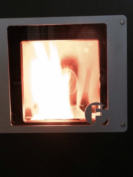

    New picture of the flame on level four since we replaced the ash pan gasket. Better?
  8. DexterDay
    DexterDay Administrator
    12,411
    31,632
    Northeast Oh
    Yes Ma'am.. Can you take a small video of the burn? Can be a short one via phone, or YouTube. Just to see how fast the flame is. You may be able to close the damper some.
