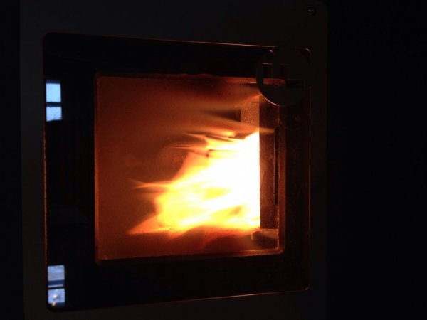

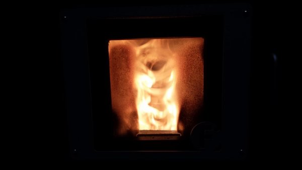

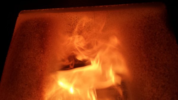

    Turn the pin that's around the 125° mark, up to around 140°. This will allow it to run longer with hotter air temp when on a low setting (1 and 2). But your still not getting above level 1. Not based on the video I seen.
    That flame isn't getting above the top of the pot. If you turn the Furnace on from a Cold Start, or "Initiate Pot Change" at the very bottom of the control settings, you will see what level 5 looms like. . Because during both of those functions, the furnace is at level 5 for about 20 minutes until it stabilizes. Level 4 is only slightly smaller than that large flame.
    Here is my level 4. (Pic with and without flash. Last pic is looking to show you that the flame should either come close to hitting, or hit the top baffle plate).
