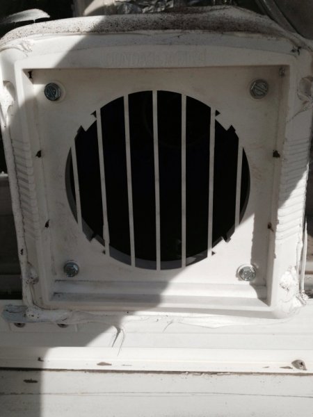

    The Garage is attached near that corner in an "L" shape so very seldom gets any snow drifts because the wind usually can't get to it. Kind of a bad picture (I just took a picture of a picture) but you get the idea. image.jpg Sorry for sideways picture.

    Looks OK, but you still need to put some sort of screen over it to keep ants, wasps, mice, etc, etc, out during summer months.

    Maybe you can sandwich it between the permanent part & the louvered part that you took off for the pic.

    Exactly what I was thinking.
