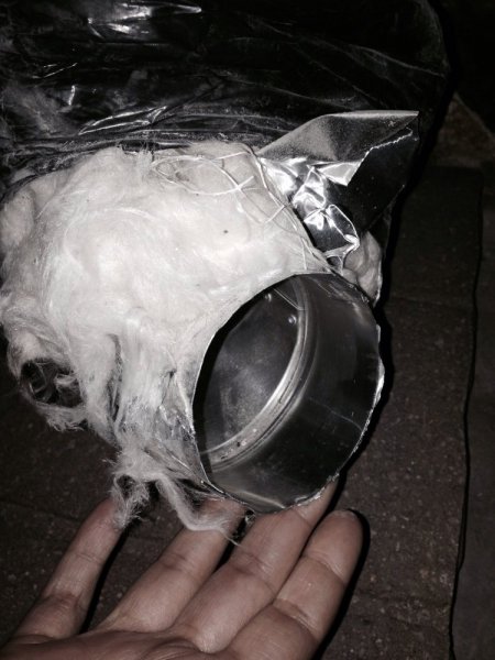

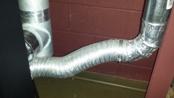

    This is what we have for our Oak, it is 3" flex pipe. Is this correct? The manual says it should be 2 1/2". Does that matter? It was leaking pretty bad when hooked up...
  2. 343amc
    343amc
    1,749
    5,765
    Northeast Lower Michigan
    I used 3 inch rigid aluminum pipe for mine ( aluminum I think) with a piece of flex pipe attached to that pipe. I found a car exhaust system adapter that slides right over the air intake on the furnace. A hose clamp goes over the connection between that adapter and the flex pipe. It's not the prettiest but it works.
    Long story short, you shouldn't feel air coming out of the intake pipe. It should be a fairly snug fit.

    I used 3" also. No worries. Bigger is better in this situation. But it doesn't need to be insulated?
    For about $30 you can do this yourself. Get some rigid and some flex. Both sold at Lowes and Home Depot. Run the rigid down close to the furnace and then run the flex over to the furnace.

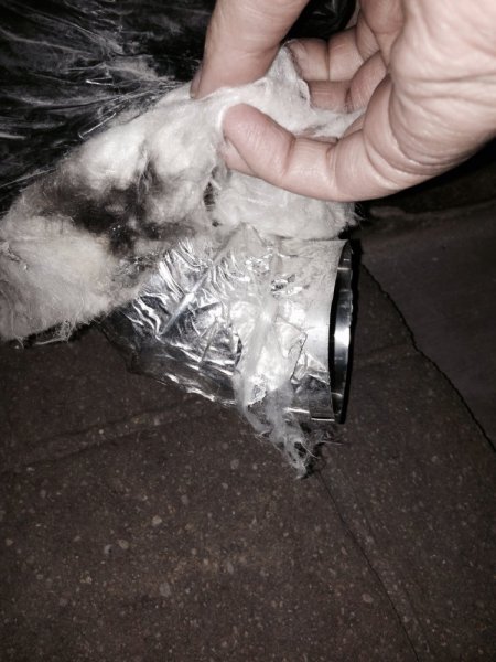

    Dex, They told us that it had to be insulated so that condensation doesn't form when the cold air comes into the warm room.
    Is that the right type of vent to use or should we get something else?

    I use a metal dryer duct as well, it has ice on it when it is cold, and drips a little, but no biggy!

    It's Still gonna form moisture. Just the insulation will suck it up.
    It doesn't need to be replaced. It should be fine..
    But... That flex can't be seen? So if there is a kink in it, restricting air flow? You'll never know. Something is causing that furnace to burn super rich (no air).
    I can look at the O.D. of my OAK and verify that there is no kinks.

    Good point, I think the insulation has got to go. Thanks

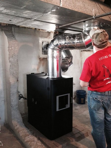

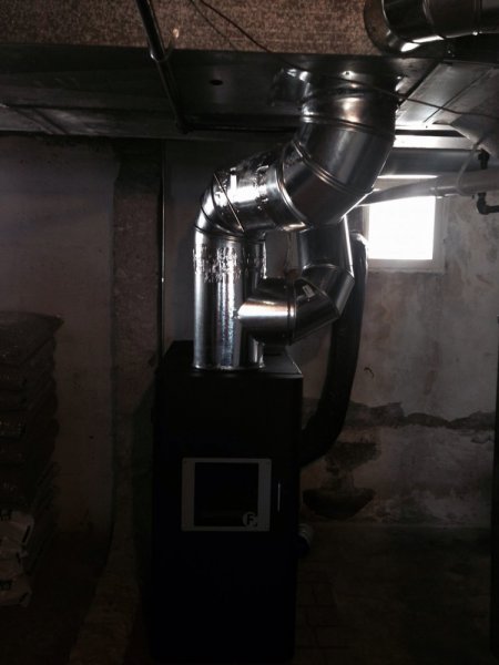

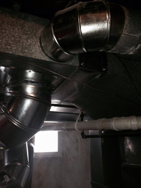

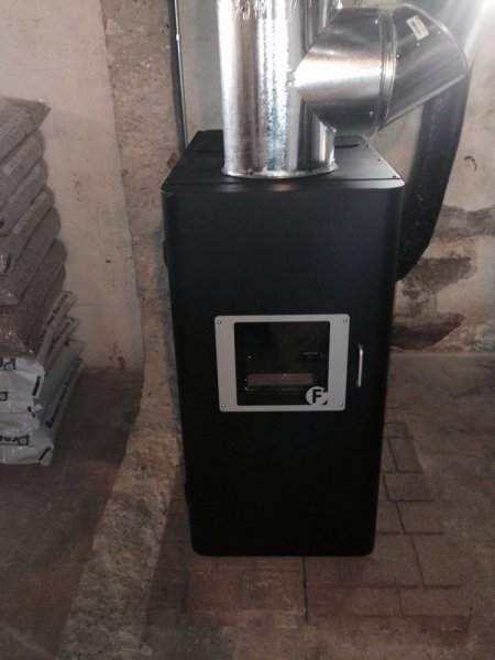

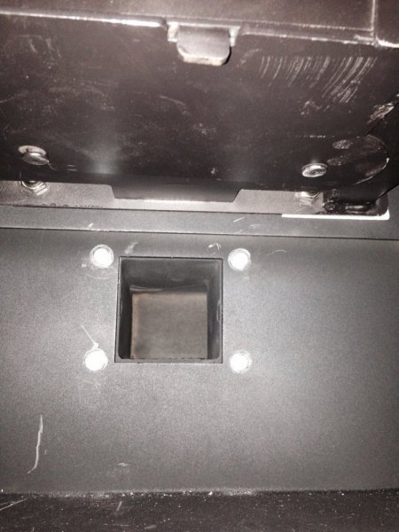

    New furnace is in except for the exhaust, that will be done tomorrow. What do you all think? Better? image.jpg image.jpg image.jpg image.jpg image.jpg image.jpg
  13. eatonpcat
    9,687
    54,040
    Looks much better to me!!
    Ward8512 likes this.
  14. DexterDay
    DexterDay Administrator
    12,411
    31,632
    Northeast Oh

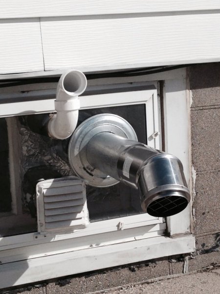

    They even used a real termination cap this time :)
    Looks good :thumbs:

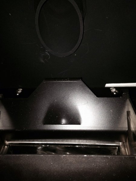

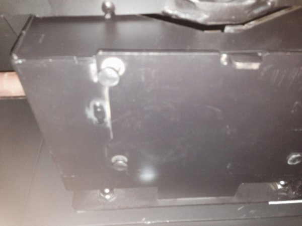

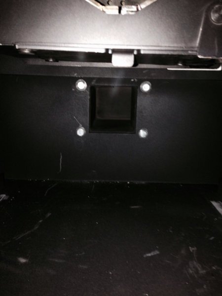

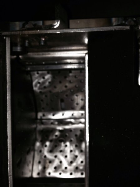

    Before the pot gets all mucked up, do me a favor a snap a few pics of the pot (outside of it and looking down in) and also a pic of the back of the ash pan area. Remove ash pan, and take a pic of the back wall there. I want to see what they did different with the heat exchanger and the back baffle area. The newest ones have an update that I can't get. It requires a whole new furnace. It's not a part that can just be swapped out. I'm curious. .
    The exhaust set up looks better, the ductwork looks better. It looks like a $6,000 job now. Congrats
    Ward8512 and eatonpcat like this.

    I got a question? ? Is that a dryer vent they used for OAK? Those are designed to open when air is being pressurized in the vent? That is an intake vent with vacuum? Wouldn't that be closing the louvers? They kinda looked cracked open? But can't tell??
  16. Ward8512
    Ward8512
    Feb 22, 2014
    715
    2,034
    Northeast WI
    No, not a dryer vent. They just put a dryer type of cap on the outside. My Husband said he had them put a hose clamp on it this time and it's not leaking anymore.
  17. Ward8512
    Ward8512
    Feb 22, 2014
    715
    2,034
    Northeast WI
    Here ya go Dex. If you need anymore let me know.
  18. DexterDay
    12,411
    31,632
    Northeast Oh
    That's what I mean. Those dryer caps only open when air comes out of them. That is an intake, so air won't come out of it. It needs to be sacking in air. If those lovers are closed? Then that explains why your furnace was running so rich and getting "Choked". Because it couldn't such any air? Those lovers need removed, and a screen put over it, or at least every other one removed.
    The intake needs a wide open and unrestricted path. If it can't get air, this furnace will run the same way.

    Thank you for noticing that, I will go check it out right now!
