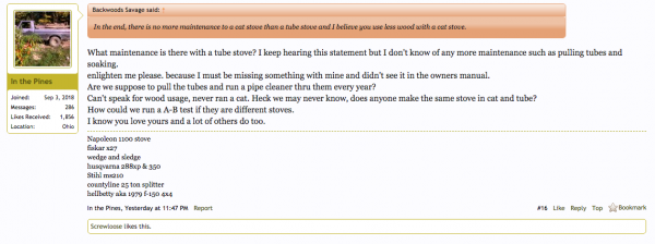

    No one can prove the payback. They don't make the same stove cat/noncat.
    Impossible to empirically prove it's worth the payback.
    Yes that is maintenance for all stoves. But that isn't what was said either.
    So don't cherry pick the comment.

    It's pretty clear what was said and what I referenced.
