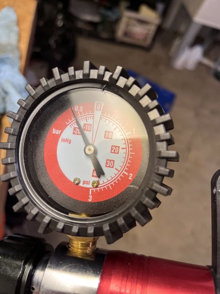

    Pressure tested the saw, and the crank seals on the flywheel side were good. Moved over to the clutch side and that was a different story. Video below of the leak.
    https://youtube.com/shorts/pDjP02uBlcc?feature=share
    At first I thought the air leak was coming from around the crank where that little O ring goes. I then noticed bubbles were coming from under the seal. Found a deep well socket that was a touch smaller than the outside of the seal and hit it with hammer gently, and the air leak went away.
    Put everything back together, and it still ran erratically. Reset both carb screws to 1.25 turns, and it idled pretty decent. Adjusted the low side a little, and it would just sit there and idle fine. High side is still a little fat but I'll play with that once I get it into some wood.
