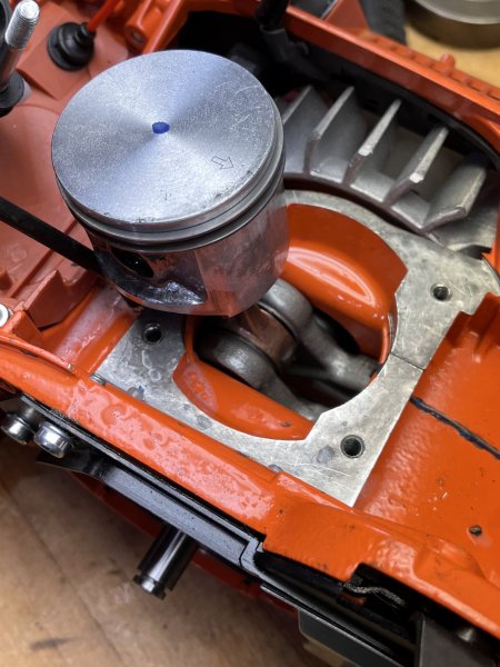

    Think I figured the problem out. There probably shouldn’t be soap on the piston !!
  2. brenndatomu
    25,337
    164,977
    How did that get there?! :startled:
