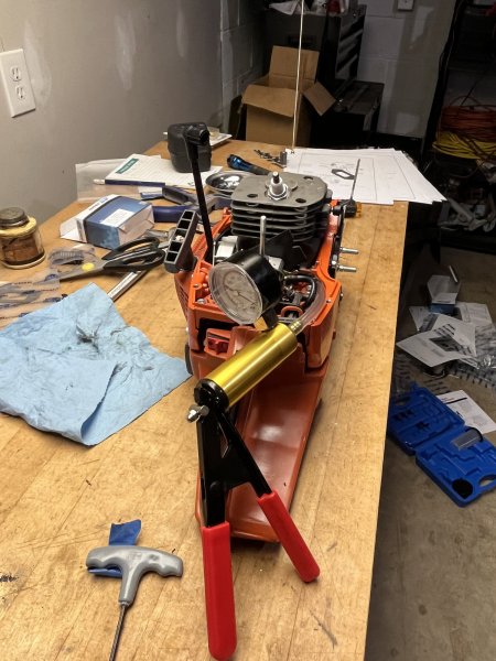

    When I vacuum tested the saw after putting the cylinder on I got nothing. Thought the issue might have been the Hylomar base gasket since I had to pull the cylinder back off again to get the carb boot and pulse line put on. Pulled the cylinder fully off and scraped all of the Hylomar off and used the paper base gasket. Still get nothing in my vacuum test. Took the decompression valve off and plugged it my finger, nothing. I have the exhaust and intake plugged with some pieces of rubber and I have my pump hooked up to the pulse line.
    Read a few posts on Facebook and I guess the rubber boot on the carb on these saws will sometimes crack. Thinking about starting it and spraying starter fluid around clutch, cylinder, and carb boot to see if I can figure the problem out. Anybody see any issues with that ? It seem to have really good compression, it would definitely be a work out to try to start it without the decompression valve.

    How are you plugging the intake and exhaust off?

    Cut some pieces of rubber. Sandwiching one piece of rubber between the carb and the carb boot ( picture above ) with the bolts tight. Same thing for the exhaust.

    Oh, ok...does that test pump have a pressure mode too? Just curious if it'll hold pressure...and if not then that might can be found with some soapy water...

    If nothing obvious, I would question how effectively you’re blocking things. A leak is normally slow and steady unless something is way off.
    Don’t start it yet. Perfect your setup and rule out leaks that will cause you tuning issues later. The brake cleaner test is ok, but often gets sucked around the air filter and makes ruling out leaks tricky.

    I'd spray it down with some water and a few drops of dawn and try to see where it's bubbling before going any further.
    If it's leaking that badly it will show itself quickly.

    That’s what I was thinking too since I can build zero pressure. There’s something wrong with how I’m doing it. I’ll take some pictures and post them.

    Take that vacuum pump off and blow on the line...see if it seems like it's holding...you don't need a ton of pressure...you could try that in suck mode too :D

    Leaks-
    Impulse line, base gasket, case gasket, fuel line/carb (which you are bypassing), intake, spark plug, decomp valve, seals. Other than casting flaws or a screw hole in the crankcase not filled (oiler, should have sealant around it), there’s really not many other places that could leak any air.

    Right… try pressure.

    Hmm...decomp valve pushed inadvertently?
