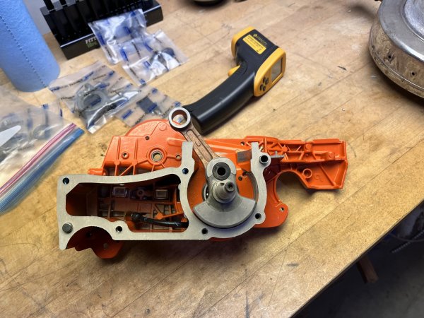

    Just placed an order for Hylomar blue and some Threadlocker M-243 ( knock off Loctite ). Talked to a friend and he has a bearing heater he can get from work so I plan on just freezing the crank and heating the crank bearings. That seems to be the route that most folks go.
    The aforementioned goodies won't be here for a few days so that will give me some time to clean the coating they sprayed on the case and maybe dig through the bolts and get them in some kind of order. My German brain doesn't deal with that kind of chaos very well. :hair:

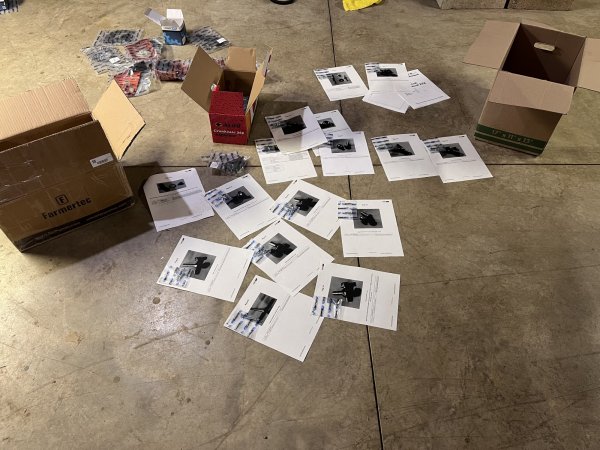

    Marked the clutch and flywheel sides of the case so I know what’s what when I put them together. I also marked the crank.
    Printed the PDF I attached and then stapled the coordinating bag of bolts to it.

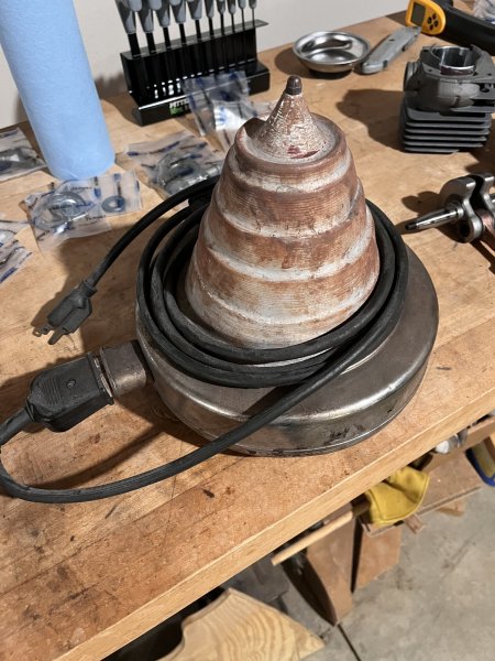

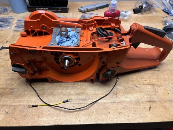

    Made some good progress tonight. A friend let me borrow his bearing heater to heat the bearings up so I could drop the crank into the bearings after it sat in the freezer for about three hours.
    The crank dropped into the clutch side, on the flywheel side I had about 1/8 - 1/4 gap between the two cases. I snugged the bolts up in a pattern to bring the two case halves together. Lesson learned, get both sides up to or close to temperature at the same time vs heating one up and then the other.
    I think I spend more time looking for stuff than what I do actually putting the saw together. Most of the parts are together but sometimes you are looking for a small piece that's covered by a bigger piece. I spent probably five minutes looking for a little piece of plastic. I'm glad I stapled the bolt bags to what they are, that has made it easier.

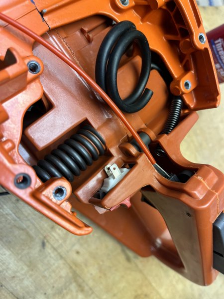

    I don't think the ground wire they sent is going to work !! One side needs to have a spade terminal on it for the kill switch. I'll cut one side off and put a spade terminal on it. The colors are way off between the metal case and the plastic too. Oh well, that's what you get for the price.
