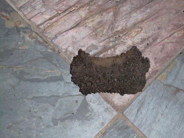

    And they quit making the unit,after all the bugs were worked out.Bummer,but appears your stove became the china clone,that someone made big bucks on.

    I'm not aware that the bugs were ever worked out. I am aware of one that hits because they don't wait quite long enough to ramp the convection blower down going from 3 or higher burn rate to maintenance burn. Haven't seen a controller upgrade for that. Work around is to override the autofollow on the convection fan or use a higher flow rate convection fan (that be this critters solution) 230 CFM instead of 160 CFM.

  7. jtakeman
    12,338
    55,622
    Looks like someone took a bite out of too!! :D
    Was it yummy?? :p
    ivanhoe, slvrblkk and SmokeyTheBear like this.

    No bites were taken. It would be crunchy, now got to see where that new burn pot is.
    The boss is out sending that bad one back.

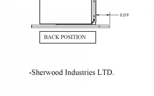

    Looks like the round of HR stoves are from Envro, hard to tell would need to get paws on one.

    DL the manual and they say Sherwood Industries LTD. Davenport is an EF-2 clone.
