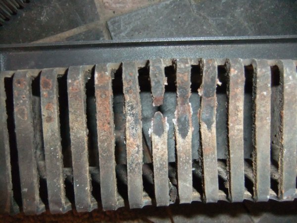

    Can you take pics of both the old burn pot and the new burn pot so I can show the manufacturer please?
    That would certainly help a lot!

    I post with no comment burn pot with less than 40 bags through it.

    No matter it is NFG at this point as far as I'm concerned. Maybe Rick can run some tests on it for me.

    That's what my burn pot looks like, all of them, after 4 tons give or take.
    Same pattern
    Same design
    slvrblkk, ivanhoe and CleanFire like this.
  13. jtakeman
    12,338
    55,622
    IHP, How many ton did you get with the original?
    We might wanna go back towards that one even if its SS?

    19,116
    Maybe like 4ish. It looks identical to smoker's, except mine in bigger and without the flange.
    Mine has always been a pos, from day one.

    My first burn pot died an early death and was replaced, the air bypasses lead to burn pot ash build up that in turn lead to a reducing air staved charcoal burn and that warped the pot.

    Don you still want my other pot pictured?
    slvrblkk, ivanhoe, CleanFire and 2 others like this.
  17. jtakeman
    12,338
    55,622
    We'll have to ask SmokeyTheBear to post pic's of his original one.
    Also maybe we make yours with a replaceable bottom? If thats all that burning out?? I certainly do expect SS to last far longer, But still have seen burnout in the breckwells.
  18. jtakeman
    12,338
    55,622
    Please do, I'd like to see em.

    David, How thick is yours?
