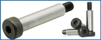

    I think I found the actuator noise I heard last season, there was a lock washer sitting on top of this slit. The top arrow shows where I found the split lock washer sitting in grease.
    Any ideas where there is a lock washer in the vacinity of the actuator L bracket?

    I don't think there's a lock washer. Everything must remain loose for ease of operation.
    Unless there is a long shafted bolt with a lock washer to make sure it stays together but remaining loose for operation, hope I make sense.
