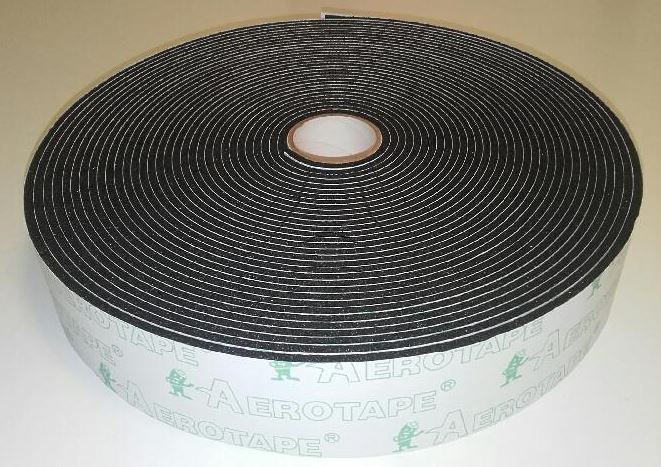

    My front door has a lot of play in the locking hardware when shut - anyone have this issue? The seal is shot and may be making the issue worse. Plan to get a new seal soon.
    ivanhoe likes this.
  12. ivanhoe
    ivanhoe
    Oct 18, 2013
    2,981
    11,869
    Northern Ontario
    It can be adjusted, at least my older furnace I was able to. I'm sure the newer door style would be adjustable. Has your furnace discolored around the door?
  13. NorthernCrew454
    NorthernCrew454
    Oct 19, 2018
    42
    70
    NE WI
    I’m talking about the big front door, not the door to access the burn pot
  14. ivanhoe
    ivanhoe
    Oct 18, 2013
    2,981
    11,869
    Northern Ontario
    I've removed the old gasket and put on cut strips in lengths of this product which is 2" wide to 1/2", you might have to double up IIRC.Aerotape™ - Aeroflex USA Inc
