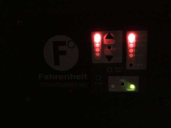

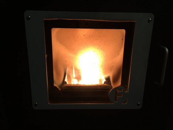

  19. 343amc
    343amc
    1,749
    5,770
    Northeast Lower Michigan
    Here are a couple pics I just took of my furnace. One is the flame when it's calling for heat (running in level 5), and the second is how the control board looks.
    I can grab another pic of how the flame looks when the stat isn't calling for heat.
    eatonpcat and ivanhoe like this.
  20. ivanhoe
    ivanhoe
    Oct 18, 2013
    2,981
    11,869
    Northern Ontario
    There's nobody in your fire, must be good pellets! :rofl: :lol: I see in the pic your heat level is at #5 & on T-stat mode. Mine doesn't go on #5, it stays on #1. I'll do a double look to make sure.
