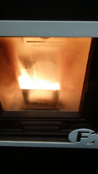

    That's exactly what I said above. Looks like level 1..
    This is my furnace idling right now.

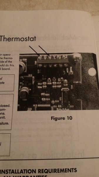

    His takes a 4 wire 24 volt tstat,diagram cannot tell if it needs jumper,older manual not so good.All it says is program in manual mode,then set heat level.

  4. DexterDay
    DexterDay Administrator
    12,411
    31,637
    Northeast Oh
    I have replaced the combustion blower (more CFM), the impeller to a larger one (more CFM), updated exhaust manifold (more CFM), new Sail Switch (more CFM), along with nee gaskets, and I gasketed the burn pot and receptacle because of so many large gaps.
    Calling 343amc. I hope he can help with this pilot burn problem.
    That thing should be kicking a flame that hits the baffle if you are on level 3 or above.

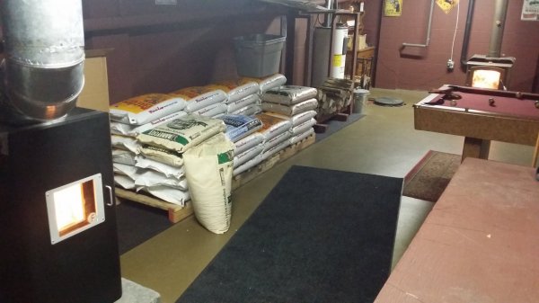

    Looks good.Also looks like stasch gettin low!But you got wood also.

    I have 3 ton in the garage and a ton in the closet off to the right..
    That's just what is kept close to the furnace. I have plenty more ;) lol

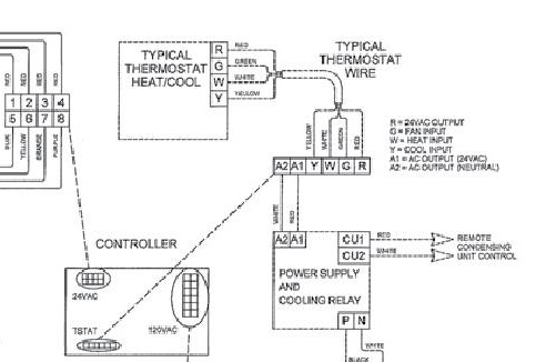

    But you only use the R and W (2 wires).
    See arrows pointing at 2 wires on page 12. Also note the wiring schematic.
    That is not the control board on the furnace. It is the back of the thermostat. Showing which 2 locations to put the two wires from the furnace.
    This furnace is no different than any standard pellet stove. So any Tstat that has its own power supply will work. It's not a 24 milivolt unit. That is the furnace (remember, the schematic shows the Existing furnace. Because this is an add on.)

    I asked Matt from Fahrenheit regarding a T-stat hook up and he wrote back with the following;
    For thermostatic controlling of the Endurance, only two wires are used (Red & White). 4 wires can be used, but only 2 are necessary. See page 22 on the top right corner to see how this is wired. Thermostat must be of the mV class. In other words, not all t-stats work on our machine. If you read the box or t-stat descriptions, you are looking for 750mV to be called out.

    So can the Fahrenheit controller supply 24V which could run the thermostat over the battery option? It looks that way according to the t-stat connection on the schematic. Just curious as I would prefer not to use batteries given the option.

    No. Must use batteries. That pic in the manual is of the back of a Thermostat, not the control panel.
    The Fahrenheit has a small 2 block connector.
    They say you can use a 4 wire line. Heck, you could use a 6 wire line. But only 2 of them are going to be used. :)
