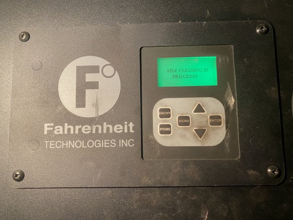

    How are you doing Ivanhoe here’s a picture of my control board I’m hoping you’re not gonna tell me I have to upgrade that

    Okay, please be careful with ventilation Steve since it's not all the way hooked up and is rigged at the moment, and put a CO detector in the garage :)

    Looks like the CB has been changed, do you have autolight option or still manual light?

    Yes it is an auto light it lights really fast still waiting on my new manifold I thought it was mandatory to drink beer while working on one of these
