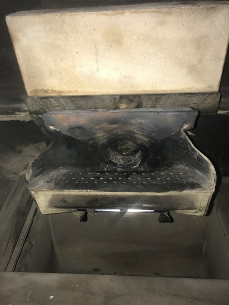

    Just cleaned everything from the back of the stove and up the chimney. Re siliconed all joints and getting ready to start up but I want to make sure I have my dip switch setting right. I looked at the board and it’s a rev E.

    Cleaned everything like a always do and lit like a dream. Only thing is I noticed the right side never had a strong flame like the left

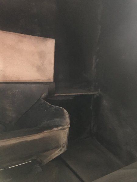

    Then if it burns for a little while and I go in and stir the pellets up it turns into this

    I'm hoping that either you had the cover under the burn pot off when taking the pictures (then replaced it) or that there is some sort of weird reflection in the 2nd and 3rd pictures. Sure looks as if there is at least a gap there, but probably an optical illusion because I don't seem to see it in the flame picture.

    I’m fricking done!!! Lit great after I cleaned it now the second time it went to start up I had to light it because pellets were falling over the edge
