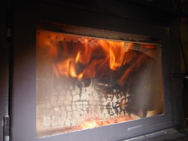

  9. bogydave
    Burning at hotter setting, 2.6
    not able to hold my hand on the pipe :)
  10. BrowningBAR
    BrowningBAR
    Oct 14, 2013
    1,379
    2,105
    San Tan Valley, AZ
    That pretty clean glass. And I notice you are burning e/w there. Why the change? Coal burn down?
  11. bogydave
    Threw on 2 splits to help burn down the coals & keep the heat output cranking.

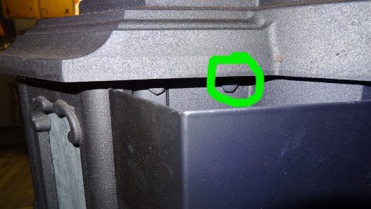

  13. Flamestead
    Flamestead
    Dec 7, 2013
    2,160
    10,926
    Windsor County, VT
  14. charlie
    charlie
    790
    997
    Schoharie, NY
    Yes I believe that's the one I was told about, closest to the flue collar.. One on either side...
