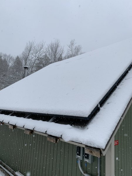

    image.jpg My array ain’t doing chit right now.
    savemoney, eatonpcat, bogieb and 9 others like this.
  16. MikeInMa
    15,912
    115,428
    I've noticed quite a few panels around here that have looked like that around here, over the past few months.

    It was 26k$ and I still pay for electricity in the winter. With net metering. Most electricians that have came to the house see that and say NOPE!
    previous owners installed not me.
