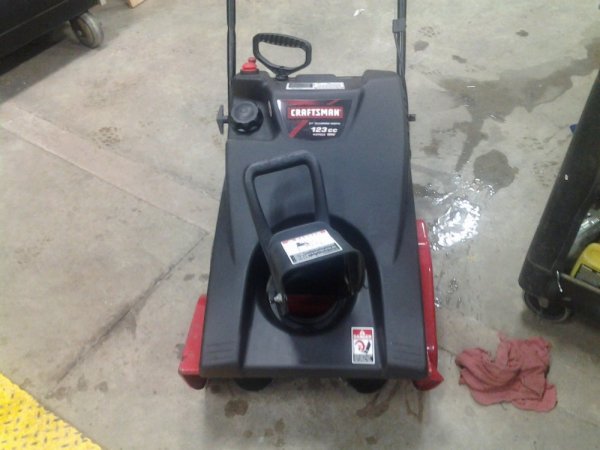

    I figured I would share this with you guys.
    A neighbor asked me to look at her snowblower the other day and I said yes. She thought the spark plug was bad because it wouldnt start or run. I said no prob, Ill fix it as soon as I can.
    Today I looked at it and it would start on choke but not run once I took it off choke. The carb has a drain on the side that allows for easy draining so I unscrewed it and caught the gas that came out in a white lid off spray can.
    i took it outside and ran it in some snow and it just didnt sound right so I took it back inside and dropped floatbowl and found more nasty fuel in it. Put it back together and she ran fine. Oh ya I put a new spark plug in it too.;)

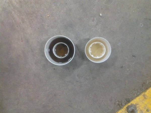

    Here is the pic of the nasty going bad ethanol that was in the bowl and the clear is after I let the gas flow for a minute.
    When I first pulled the plug I thought she mistaked her 2cycle gas can for the 4 cycle. But then I looked in the tank and it was clear. The moral of the story is ethanol sucks and pull the float bowl off to clean out carb. :)

    Is that a deteriorating "O" ring or fuel line making it dirty ?
    Many small engines don't do ethanol well.
    Some mfgr's are slowly changing components in the new ones so they don't react badly to ethanol
    Older engines, :confused:. Drain when not using for a while helps.
    Chinese engines, not sure which ones or if any have ethanol friendly parts.
