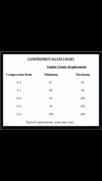

    Compression ratio does not tell the whole story. Engine design, bore diameter, combustion chamber shape all play a part too. My last truck, a 2005 GMC Canyon with the 3.5L I5 had a compression ratio close to 11:1 IIRC and it ran just fine on 87.

    That chart is about correct for older pre computer stuff. The newer stuff with knock sensors, timed injector spray, adjustable timing, etc can do much more.
