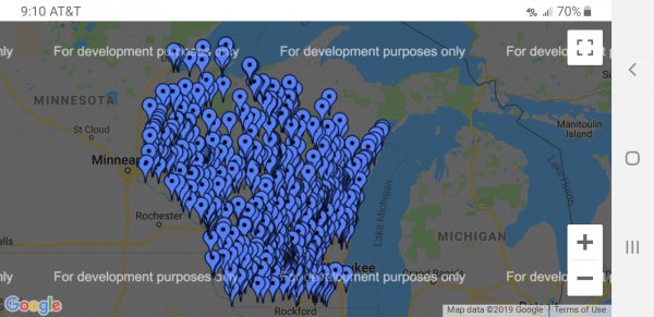

  4. huskihl
    huskihl
    Jan 30, 2016
    3,728
    21,489
    Chaz, Marvin, WeldrDave and 1 other person like this.
  5. Horkn
    29,268
    167,122
    Lol. Their site is wrong. You'll have a lot harder time trying to get e free in this state than the site says. I went down the list and found a couple that I know for 100% fact that the 91 they sell is e10, despite what the site says. There's stickers on the pumps saying that even the 91octane is e10. Also, all the Kwik trips listed that have 91 as efree, well when the tanker pulls up with 91 that is e10, in it goes....
