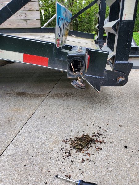

Trailer lights came on when plugged in...unplugged and squirted some dielectric grease in and replaced, now no lights. Truck fuses look good. Any help is appreciated.

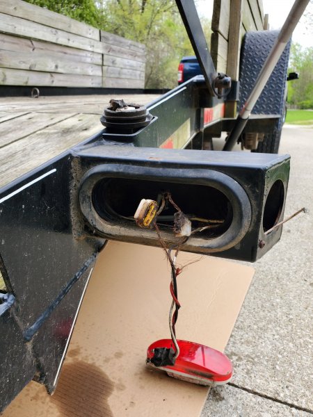

Looks like a mouse chewed your wires and caused a short...dirty bastages! That's gonna take at least a little rewiring...
