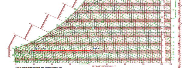

    If you want to be technical what actually happens in the winter is that the inside relative humidity is typically significantly lower than the relative humidity outside. This is assuming:
    • The house isn't super sealed for infiltration. You get at least some infiltration of outside air. I don't believe it has to be a lot of air.
    • The amount of moisture being generated inside is minimal (such as a reasonably good bathroom exhaust fan & not water boiling especially day). Another cause of high humidity would be when you have a lot of people over like for Thanksgiving or Christmas vs. regular occupancy.
    • You don't have a humidifier operating in the house.
    In one example say your outside air conditions are:
    • 40 F RH= 60%
    Your inside conditions (assuming your inside space temperature is 72 F) should be around:
    • 72 F RH=18.8%
    Here is that data plotted on what is called a psychrometric chart:
    If you notice the line basically goes horizontally from your start conditions. Thus even if say your outside air conditions are:
    • 40 F RH= 100 %
    • 72 F RH=31.3%
    I hope this isn't too much information and helps vs. confuses.
    Using heat to lower the RH (by raising air temperature) is also how both green houses and kiln drying manage to dry wood more quickly. With those processes I believe instead of straight line from left to right it slopes up due to significant moisture being generated in either the green house or kiln.
    Hopefully I am not getting too technical. ;-)
    I am curious what people's thoughts are.

    A rule of thumb that I learned for calculating RH change with respect to temperature is that the relative humidity will double with every drop of 20 degrees F and cut in half for every 20 degree gain.
