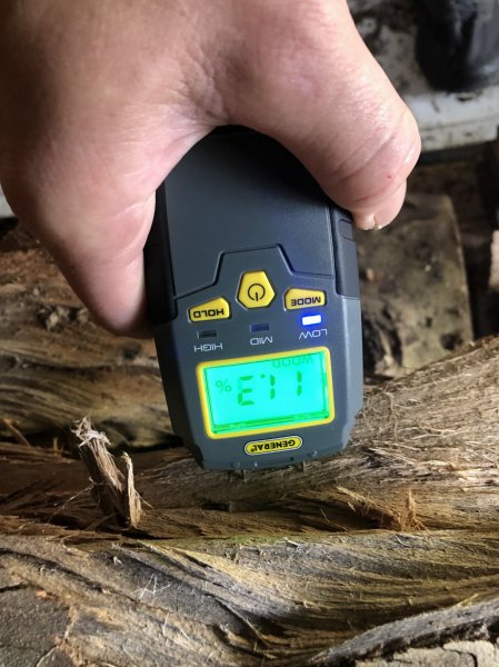

    It’s been pretty humid 80% or better here in Delaware for the last three months. Finally dropping now as are temps. I just got my moisture meter in today and tested a few pieces of wood and I’m pretty happy with the results considering I just split some of it. Lowest I got was around 11%

    Appreciate the info. I certainly hope it’s pretty accurate. I can’t wait to start testing all my wood splits! Wondering how far do U have to push the prongs in? Also, should I split the piece in half to get a reading from the inside?

    Yes, must split fresh. Readings on the outside have no value. You don’t need to poke the pins in far. I’ve had the real cheap Chinese MM’s and pushing with any force would break them internally. A fresh split doesn’t require any real depth and now you know what the reading is at the center.

    They say the only way to get a true reading for wood is split the wood and then do a moisture reading. Reading moisture content otherwise isn't accurate, e.g. taking a piece of wood off the wood pile and reading its moisture content without splitting.

    So u guys were spot on! I split a few pieces that I tested yesterday and found the moisture content significantly higher around 30 or better. I’m stacking it outside facing the wind and where the sun will hit it for the better part of the day. Just hoping I can get some down to 20 before winter. So disappointed I didn’t start sooner. I will be bringing in a bunch so that the stove heat will dry it out a bit.
