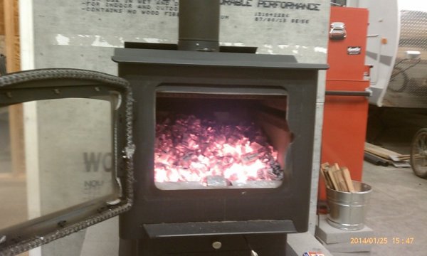

    While a stove can make a certain high btu, there are some challenges to maintaining that high output over an extended time. I have and like an NC30 that I burn as hard as safely possible intermittently. Here is what happens when I have a long day trying to keep it hot....
    It fills up with coals and I can no longer keep the output high. See pic.
    So what to do? If you are needing every bit of what the largest stoves are rated to put out then you need a wood furnace. Running at max output on any stove will be frustrating. I would much rather load 300# of wood per day than freeze and if you need 300# then you need 300#. Now find an appliance that can handle it.

    There were no ashes in that stove, all coals. An ash pan would not have made a difference, oh and I do believe that the stove does have an ash pan.
