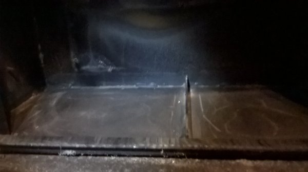

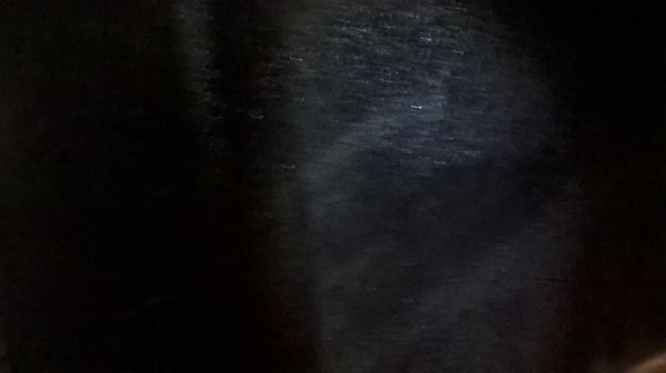

    WP_20160125_00_58_10_Pro.jpg The pot lasted a week before I had to clean the carbon off again. When I pulled the ash pan there was a lot of creosote. This is a result of burning Southern Indiana Hadwoods. I have burned these in three different stoves and they did this to each of the stoves. My sister burned just one bag in her stove and it got so caked up with creosote the exhaust blower was slowed down to the point of vacuum failure.
    I tried a different cleaning method on the carbon this time. I used steam. I have a Shark steam cleaner I use to decrease engines and parts. The end result was the same, the time it took to clean was the same, about the only advantage was there wasn't as much dust being blown around so I'm not spitting carbon. It was alot messier. I will be tryin g something else next time. I think ill stick the liner in the oven at about 400* for a while then toss it in a bucket of water and see what happens.
    I dont know how well you can see but the pics are of the.creosote.
