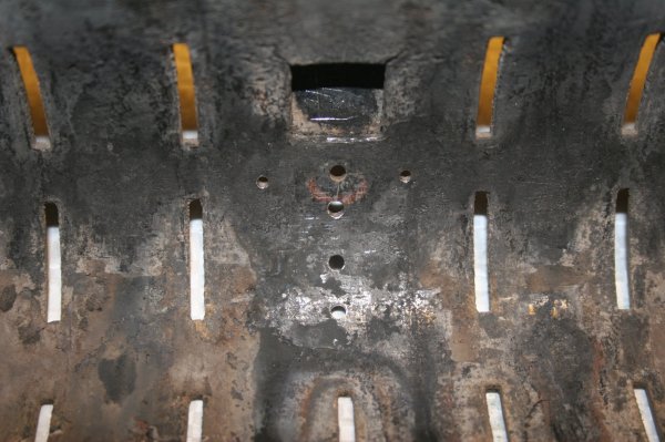

    I'm about do to order a spare for mine. I've repaired my pot 3 times now. 1once for the shroud breaking off and 2twice for crack's. I've also drilled several .125 holes where ever carbon was building up trying to reduce it. So more holes to me might be betterer!!
    I was thinking the M55 because it uses slots instead of holes. Pretty sure the burn pot grate and burn pot are the same part numbers. Augitator is also the same.
    I was going to go with the after market ag when mine go south. Did you get the after market burn pot liner??

    Still getting lots of carbon build up?
    I drilled a chit load of holes in the Omega liner. I think I even drilled more after these pic's. Hole diameter is the same as the slots width IIRC.

    No build up yet with the Green Supreme pellets. One week in.
    I drilled my pot too but it didn’t help. I’m beginning to think my carbon build up is from the Somerset pellets I always used.
