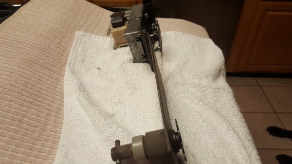

  7. eatonpcat
    10,366
    59,226
    Okay....Splain this disaster! Sprocket is mangled and I think the support bracket is also tweaked. Any ideas on what wasn't turning? Front sprocket moves freely and it appeared to be cleaning the burnpot.

  8. smoke show
    smoke show
    2,983
    13,948
    Pittsfield, Wi
    Straighten that effer out and slap it back together.

    Denver, NC
    Actually, what Smoke said is what I would try. Remove the bent sprocket and flatten back as close as possible to original, and do the same with that long "bracket" that looks bent in the 2nd pic. Hard to diagnose just from those pics.

  15. jtakeman
    12,330
    55,579
    Looks like I thought. Sprocket slipped off the motor shaft. As it tried to pull the chain off it fubared the bracket and bent the sprocket. I too would do as smoke said(carefully hammer em straight).... Pricey parts to say the least.

  16. imacman
    imacman
    Oct 23, 2013
    6,636
    27,536
    Denver, NC
    My best guess, based on what I see in those pics, is that the chain tightening adjustment worked it's way loose, and the slack chain tried to jump off the sprocket. As it did, it put a good strain on that long bracket and bent that too.

  17. eatonpcat
    10,366
    59,226
    Thanks...I will do my best to straighten it out. Not sure how to get it all lined up, but I will get my BFH out tomorrow and do my best to realign!

  19. jtakeman
    12,330
    55,579
    Agitator Drive Bracket #50-2038 cost about $75 bucks
    Agitator Drive Shaft with Sprocket #50-1698 cost about $65 bucks
    Motor Drive Sprocket #50-1700 cost about $45 bucks
    Drive Chain should be fine, But JIC here's the number #50-2059 cost about $45 ish.....
