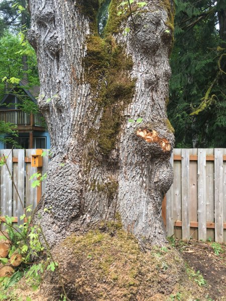

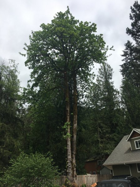

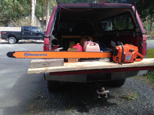

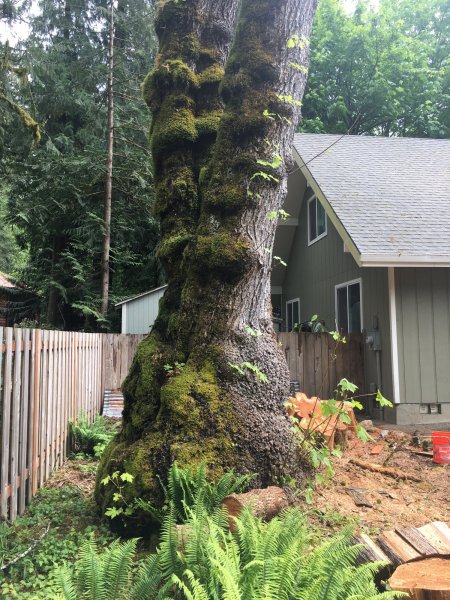

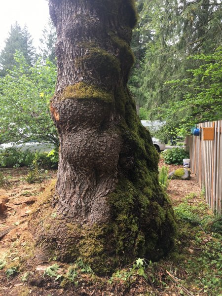

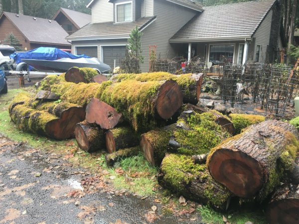

    I don’t even want to think about using that thing for felling, it is much more nose heavy than I expected. That is my 60” bar, I was really surprised at the difference between the 44” bar and the 60” bar. The 44” is a bit nose heavy, the 3120XP balances nicely with a 36” bar, but that 60 is a real bugger to lug around. I bought it for milling, I eventually want to try building some Tables, but I honestly haven’t milled anything that needed that bar yet
    I really wish that I had ordered a 50” Husqvarna bar when they were available, the 50’s are now NLA. I can still get the 50” from GB, who produces bars 44” and longer for Husqvarna, it would still be orange with the GB logo instead of the Husqvarna name on it, but I would have to order it from GB in Australia.
    730A151E-8EF2-4E33-8DE9-4D8519FCCB91.jpeg 39720595-0829-4EF1-9016-91029A682DB5.jpeg 51812A30-501B-40C2-9B4B-21C4A3A577E0.jpeg 3A29C5E0-942F-4844-9CA4-4890B4F3B7C6.jpeg 68681D8F-138B-40CD-BFBE-A8D5F713358A.jpeg B7CA0C7D-F029-4166-9FE9-054E2C3537EE.jpeg
    The neighbors across the street had this Huge Maple taken down, I have a 72” bar and mill that haven’t been mounted or assembled yet to mill the lower part of the trunk, and the upper stems are piled in front of my house waiting to get milled. I’m Glad that I already have the 60” and 72” bars, they’re still available, but so was the 50” 2 weeks before I went to order one, 3 different places showed them in stock, then 2 weeks later, none to be found
