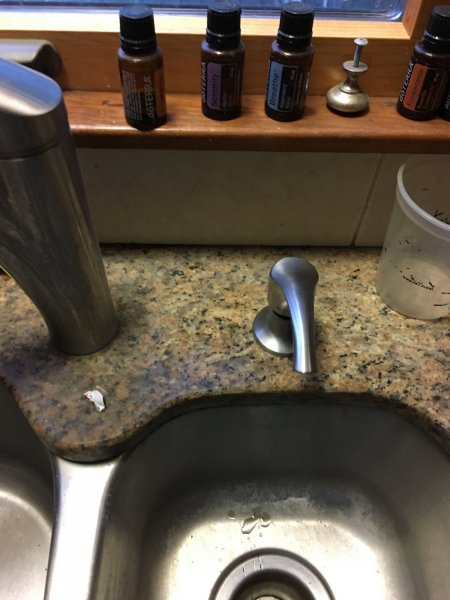

    Well I couldn’t find anybody to come out for what I felt was a reasonable price so today I made time for this job. A dremel 200 and 3 rotozip bits got the job done for 22$. It was slow and dusty.
    We’ll see how long it takes Mrs. warner to notice it’s there.... 02476DE1-9C55-4E6C-9223-65A617427DBB.jpeg
