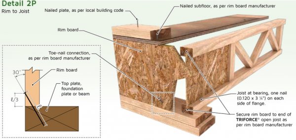

    Basement stove here as well. The earth acts as an insulator. Maybe not a terribly good one, but one. What's the max freeze/frost line in the ground in your area ? The drier the earth is the better, so drain roof water as far away as possible. What really sucks with concrete walls in the winter is the % of wall exposed to the cold above ground.
    Rim joists can be a terrible source of cold air infiltration and it can be worth every minute spent air sealing them as long as they are air sealed well.
    I think the worst air infiltrator type is the open manufactured joist which can turn a whole floor ice cold above a finished basement , especially with a foundation overhang where so many of these joist types are used in far too common raised ranches.
    With no rim joist and sloppy cuts on the ply or particle rim board there can be gaps the size of your fingers letting air go right thru any fiberglass insulation they may or may not have stuffed in the cavity.
    Like this:
