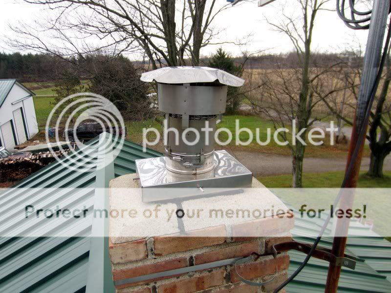

    I was getting a headache reading all this woe. Ive a question.....after the pipe goes into the chimney, where does it terminate? Have you checked the chimney cap? Critter in there? Spark arrestor on cap partially plugged? Sorry if this has been asked/answered b4! Just a coupla idears.

    No clogs, I just brushed it. Easiest way to answer that is with a picture.
    That pic was taken with the 5.5" liner still, and has been replaced by 4" Simpson Pelletvent, but the appearance is the same. The same clamp holds the pelletvent, it ends inside the raincap.

  19. Lousyweather
    Lousyweather
    Dec 23, 2013
    2,798
    9,040
    cool- just dotting the I's and crossing the T's.....often issues are pretty simple.....I can kinda see the screen in the cap, looks pretty clean!
    I am not familiar with those units....any way to get a draft reading?
