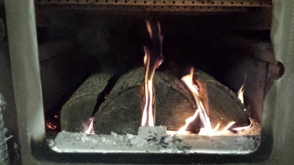

    Those were med sized spilts. As joked above rectangular pieces are best.
    A large split load is normally 6 -8 pieces. Depending on shape.
    An 8 piece load of square/rectangular pieces is my favorite. That way there is 2 pieces to the left and right of the dog house, and I arrange the top layer to cover that gap of those 2 pieces on the bottom. This ensures that the dog house air is forced down the channel of the bottom center splits.
    The top pieces were about 7"-8" across.
    Bottom row was a little small, but was still a bigger load. Also, notice the splits are arranged so the dog house air goes to the back of the stove.

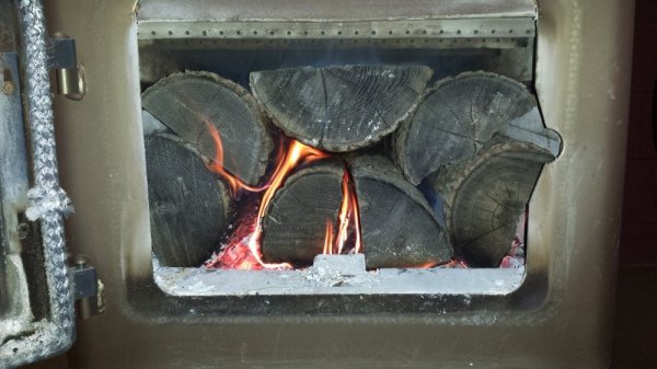

    This is a load when I am home. I run with more air and run hot loads. It helps me save pellets. :) Spaced far enough for good air, but tight enough to help each other burn. I always shoot for the dog house down the center.. ;)

    Holy moly Dex, that's half the splits but just as much wood as my last load.
