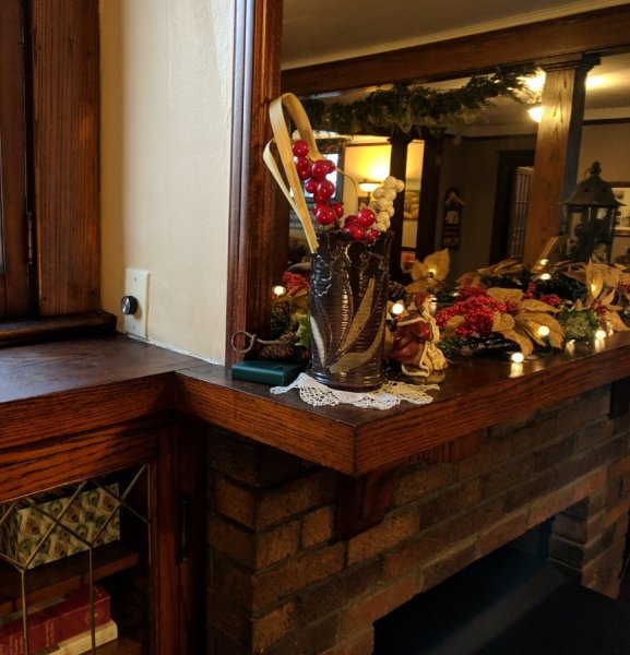

    Took an extra day but finally had the inaugural lighting of the stove last night. While installing the junction box for the rheostat a chunk of the wall fell apart (old plaster and lathe) so had to patch that up and repaint. Also had an alignment issue with the wall thimble, but all is taken care of now. Only had a very small fire in it last night, just to make sure everything was working and sealed properly. Everything seems good so far. There were even coals this morning even though it was a tiny fire. I didn't expect that. Anyway, here are a couple pics. More to follow.

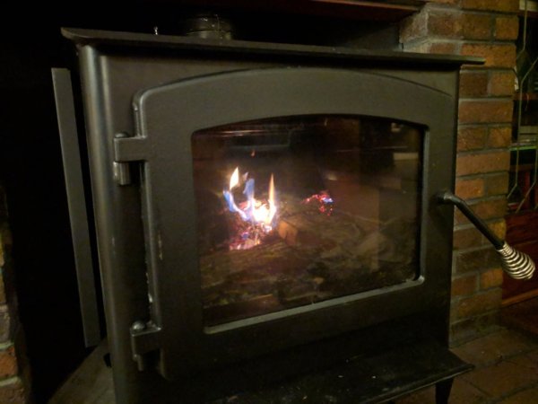

    I think I have secondary burn. Starting to smell the stove and pipe paint burning off as well. Starting to throw off good heat too! Very excited! IMG_20181221_202655.jpg

    Great looking stove and hearth! Enjoy! Perfect timing to boot.

    Your paint is very shiny, I don't remember mine ever being that shiny.
