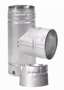

    Obviously i'm not running it until I get this fixed, which is unfortunate because it's probably the last below freezing day we'll have this winter. For starters it was filled with ash, which I believe is the purpose for the elbow. So I'll have to check that as part of normal maintenance from now on.
    The vent pipe detached, looks like there was some sticky stuff holding it in. What is the standard protocol for fixing, is this a professional only job? Is the size the wrong for the pipe? I can put it back on, but it's barely held on. What do you guys recommend?

    Are you saying that this piece was attached directly to the back of your stove??
    This is just a cleanout tee that can be placed between any two pieces of the vent pipe.

    Yes that cleanout T was attached directly to my stove, I would like to do it the right way if I can. I ordered the second adapter piece.
    Is this a DIY job?

    You need the stove adapter , which allows the vent pipe to then be attached to the stove and yes it's a DIY job .

    To do it correctly the new adapter should then be screwed to the stove with like 3 screws and make sure you seal it with hi temp sealer .

    I have the new adapter it works great! It fits perfectly. But what sealer would you recommend?

    Any HiTemp silicone 500* or higher

    No that is cement and gets hard you want high temp silicone. Something like this.
