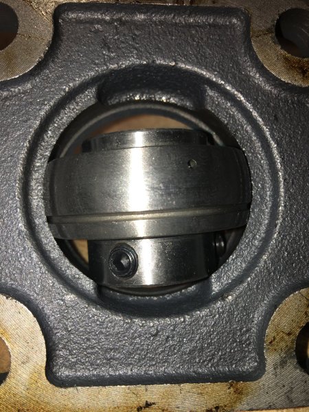

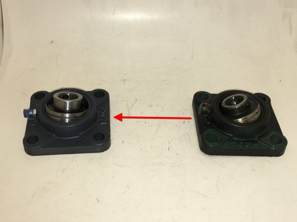

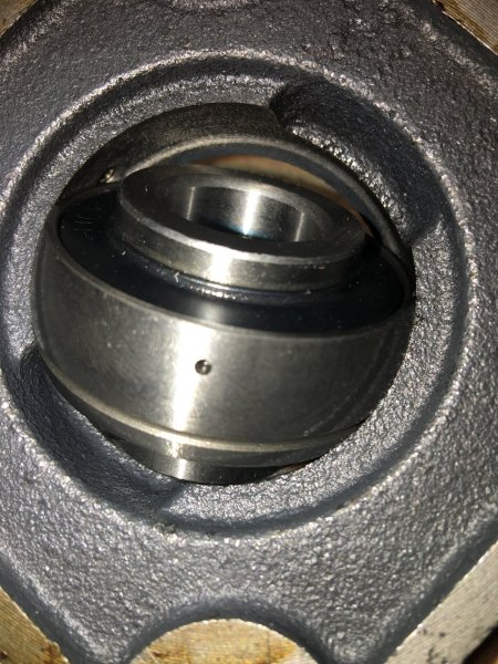

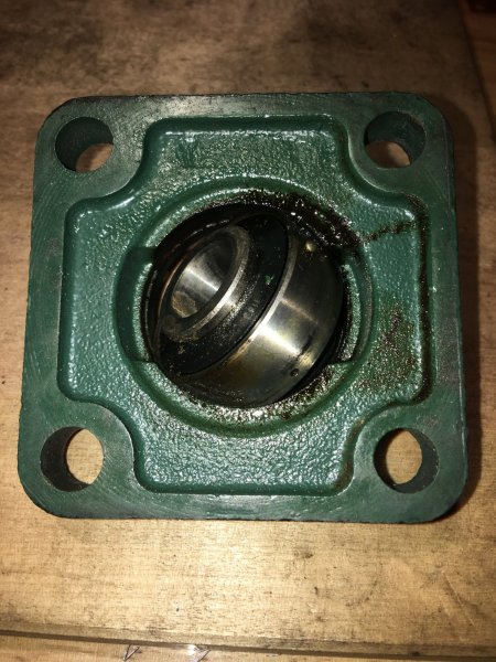

    The only way to see if they do have the grease channel is to remove them and tilt the bearing to see as in my picture.
    Pic 1 - Old bearing
    Pic 2 - New Upgraded block bearing with grease channel

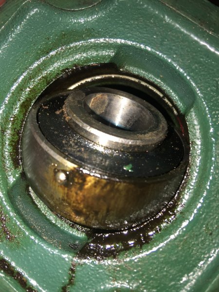

    Here is another pic of the inside of the old block bearing with no grease channel and definitely green in color. :)

    Don, Are your sure the housing doesn't have a grease channel in it? Looks like grease was all the way round it.

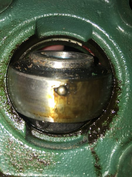

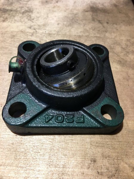

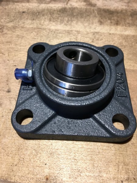

    Hi Jay
    Oh Yes the bearing housing does have a channel on the old bearing and the new bearing.
    However the new bearing has the additional Chanel in the bearing itself!
    Therefore it does work better right?
    See pics
    1-2 -- old green block bearing
    3-4 -- new blue block bearing
