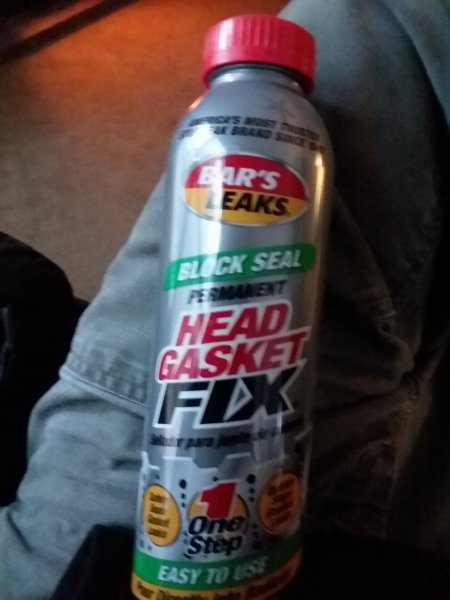

  13. Well Seasoned
    83,790
    This is all they had. Says for head gasket fix (which i don't know is the problem for sure)
    I could go to o'reilleys and see if they have the k & w stuff.
    I also swung in to get a quote for a head gasket replacement, a new water pump, and a new timing belt. They quoted $1500- $2000, that's doable, but I'll try the cheaper method first.
    Horkn and brenndatomu like this.
