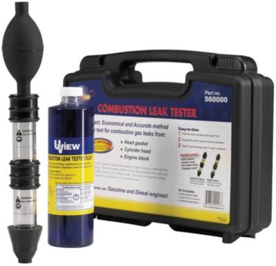

    Should be a available at any parts store.

    Bear in mind that those leak detectors are not always accurate, should be, but sometimes false negatives happen
    I've had mixed results with them

    That’s it. Just got back from town. Make sure you don’t suck up any anti freeze or that batch needs to be dumped and refilled with new.
