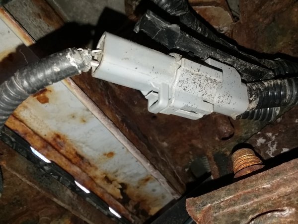

  3. Well Seasoned
    83,790
    They both go directly into this connector
    Eric VW, brenndatomu and Horkn like this.
  4. Warner
    Warner
    Jun 19, 2017
    7,368
    47,704
    Keep following where they go.

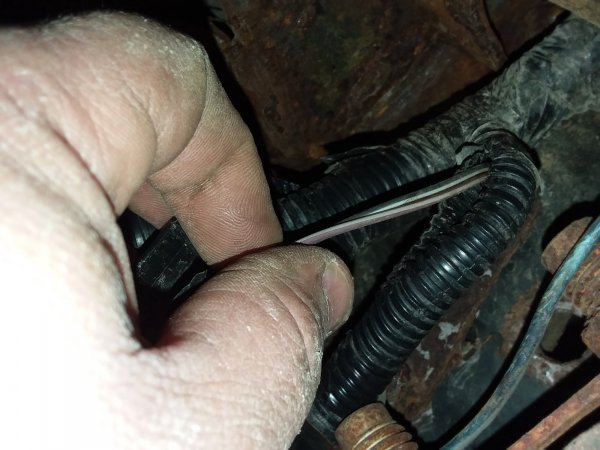

  6. Well Seasoned
    83,790
    They continue into the main wiring harness
    Eric VW, Horkn and brenndatomu like this.
  7. Warner
    Warner
    Jun 19, 2017
    7,368
    47,704
    One of those is black with wight the other is violet with wight make sure you get the right one.
