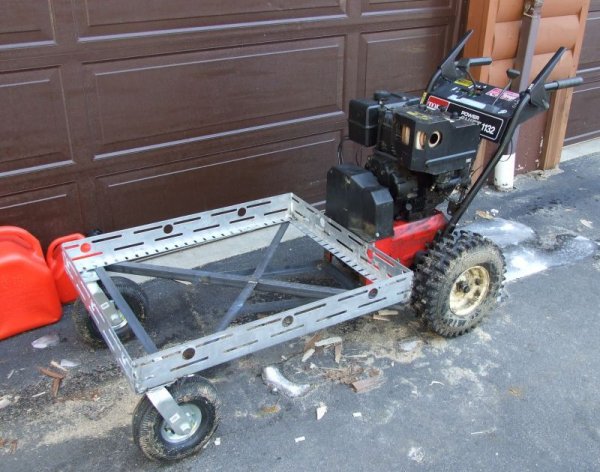

    Yeah, I built a red neck version of a DR Power Wagon out of a snow blower frame, motor and drive mechanism. I put a box on the front of it with big castor wheels. But as others pointed out above, these drive mechanisms aren’t designed to move the weights involved in, say, moving firewood.

    If you do a search for “diy powered wagon snowblower” you’ll get lots of results. I don’t have any photos or dimensions. I built it roughly based on the images I found online with sides about 2’ high: F1864983-1E0B-4AD1-9CEC-BC0A5EC11D6E.jpeg E593F058-6D84-4220-9F9B-663D75A28B0C.jpeg
    Mainly we had trouble turning it, especially when loaded moving over uneven ground in the woods. And the drive mechanism kept slipping.
