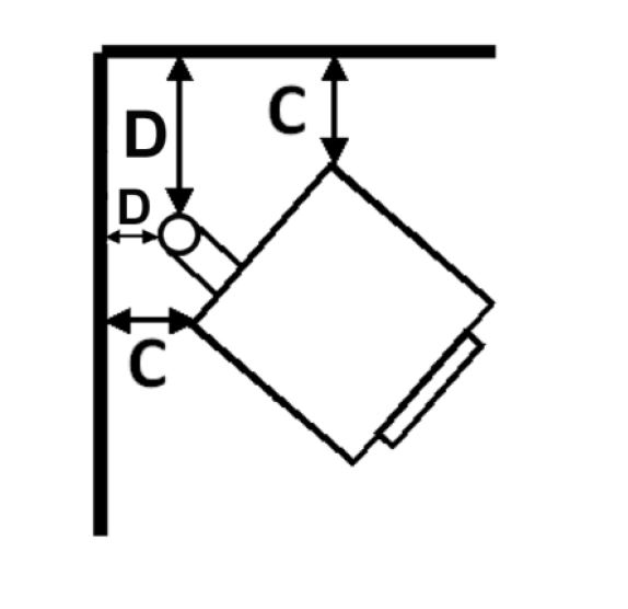

What? Table reads just a few inches from the walls in the diagram, whats it the 24" note on the bottom? (taken from the manual) Note: We recommend leaving 24″ on each side of the stove and 12″ at the back of the stove in order to facilitate access for maintenance. We are putting this in a corner, totally new installation. I now question how far out from the wall(s)? Especially since we are cutting a new hole in the roof. Thank you for any input.

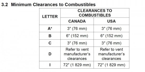

Use the charts in the manual for minimum distances. Dimension C is 3 inches minimum, Meaning you can't go any closer than 3". To be safe I'd add a couple of inches, But if you have room? I'd add enough so you can squeeze by to work on the unit. No way in heck could I squeeze in a 3" space!! Dimension D is the minimum distance the venting requires. You'll need to look it up in the venting your going to use. Again I'd add some extra clearance for safety sake.
They are just saying the more room you leave around it the easier life will be when you eventually have to service the unit. But you could do the bare minimum the manual requires.

Thank you. It will be further out from the wall than minumum clearances. 1) for servicing, and 2) to accomidate the funky trusses for the exhaust pipe, we are going straight up.
