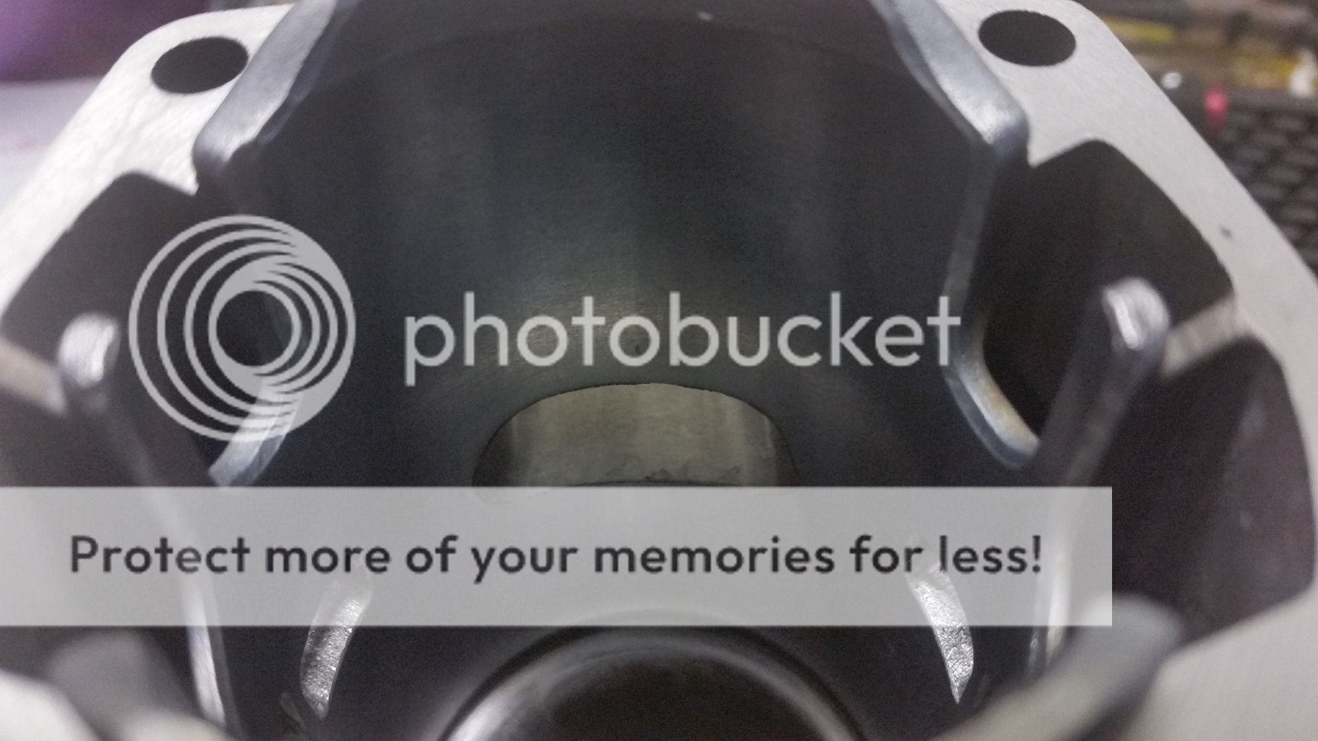

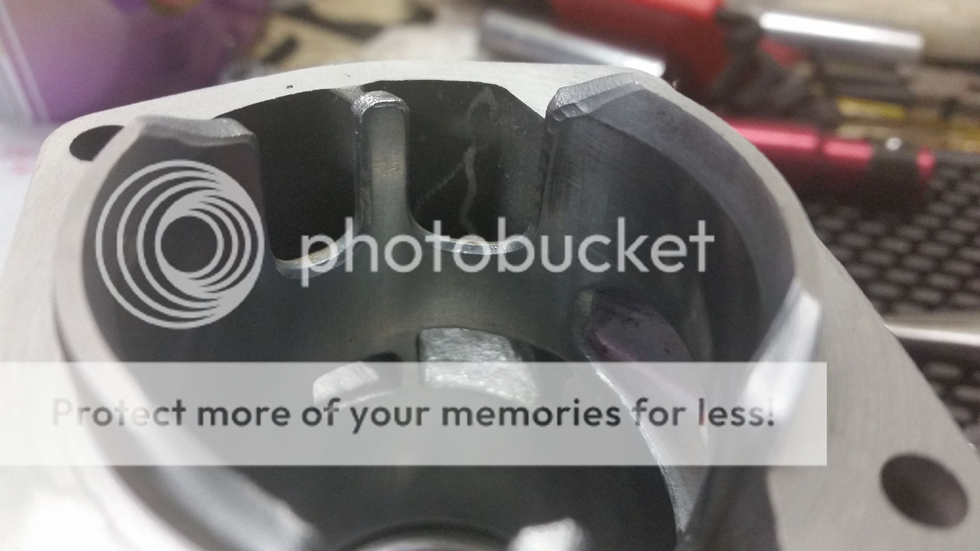

    Ex set at 104
    Transfers at 124
    Intake at 81.
    I widened both the exhast and intake just a bit.
    Progress...
    All put together. With the 620 coil. Couldn't get it to pop, gotta get impuls/fuel lines spark plug and a carb kit.
    Swapped to the original coil and still no pop, even with fuel down the carb. Have to double check a couple things.
    Numbers ended up a bit higher that I was wanting, but should be able to take advantage of the unlimited 620 coil.

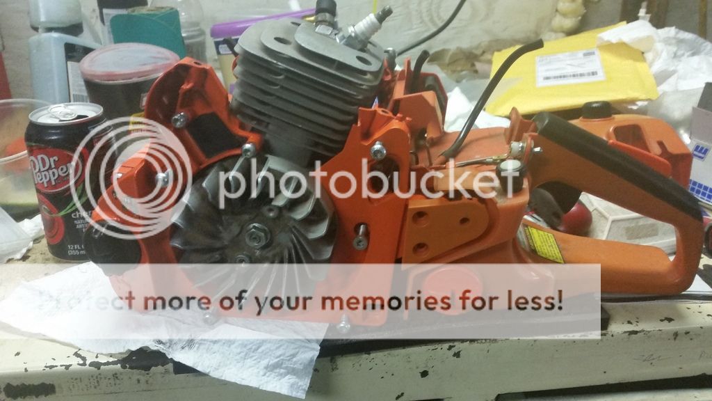

    Got all the parts to hopefully get it all fixed up.
    Should have a stock 590 here soon to compare.

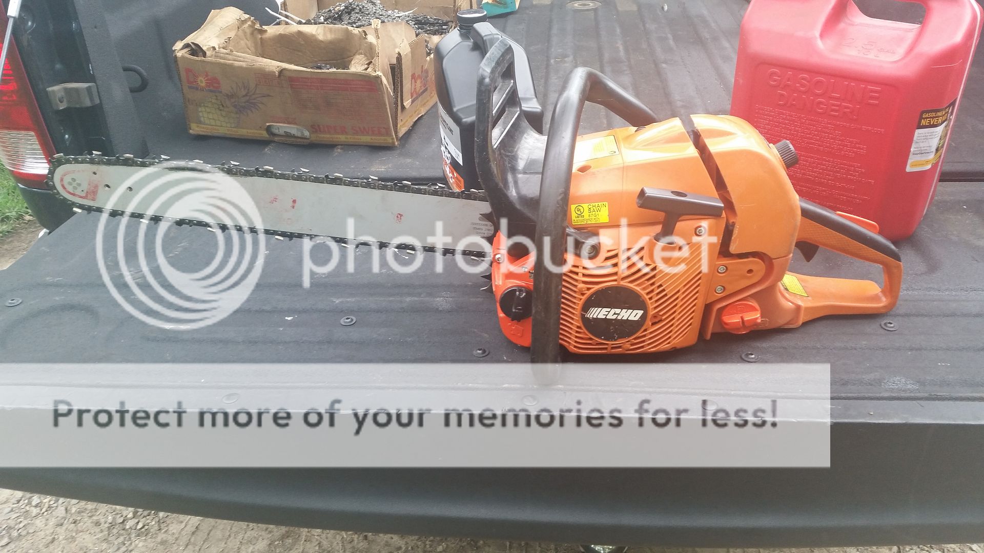

    Well heere is a clip. Barcroftb running trigger.
    It was set at 12500 ish could only get it up round 13,200 still 4 stroked through the cut. Once I get a 620 carb installed I think this will be a nice saw.
    First cut just letting the chain do its thing. Second, well you see :)
    70 dl of stihl 3/8.050 rs fresh off the roll.

    Stout saw! It took everything I gave it on the second cut and asked for more! Can't wait to run it after you get the 620 carb on it.:saw:
