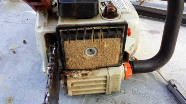

    First of all I got it out and started it up, it was hesitating a little bit and wouldn't stay idling.
    Then I tuned it a little bit and it ran pretty good but I had to turn the idle up to get it to idle, anyway didn't seem like it was running quite right, I went to take the air filter off and found out I did not put the plug back in after I tuned it the last time, then I took the cover off of the air cleaner and found this.
    and there was a little bit of sawdust on the other side of the filter.
    So I cleaned it all up and then I had bought a new plug so I put that in.
    I was going to take the plastic limiters off but didn't want to go take the whole carb off.
    Put it back together and tuned it by ear, cut some poles I had out there ran it for about 15-20 minutes, shut it off for 15 minutes, that it started right up one pull with no choke.
    I think it's tuned pretty good but I think it could be better with the limiters taken off

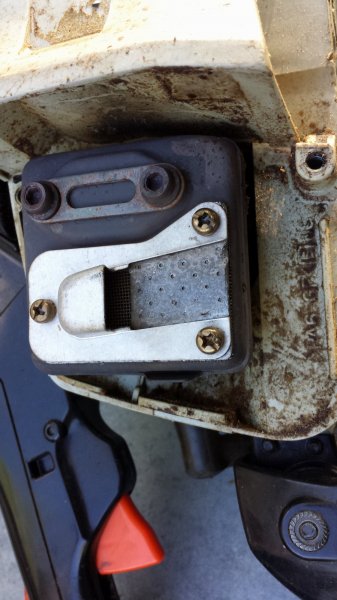

    this pic somehow got taken the wrong way but, what is this extra gasket deal on top of the screen, do I really need that there can I cut that out and open it up?

    Wow - that'll do it. Any sawdust visible inside the intake? Glad you found the problem. Cheers!

  6. bogydave
    37,220
    FYI
    The screen is taking up a lot of space & restricting the exhaust .
    Some how, on mine, the screen broke off the tab, I put the tab back on, but couldn't
    re-attach the screen so on my saw the screen is missing.
    does run a bit cooler though :)
    ( Another note to self, "Need to get one on order" )

  8. HDRock
    17,268
    60,522
    what do you need that screen for anyway, do they keep from catching your pants on fire :Ddid they put those screens on the older Saws?

  10. bogydave
    37,220
    Required in some locations & in some states cutting areas.
    Not required in Alaska.
